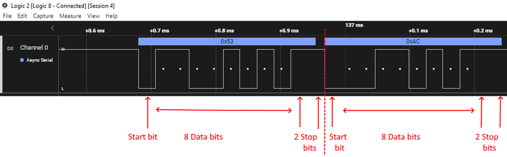

I am attempting to configure the UART2 peripheral of the STM8S105C4 MCU with an even parity control using this development environment: ST Visual Develop, ST Visual Programmer, STM8 Cosmic compiler, Library: STM8 Standard Peripheral Library (SPL).
Problem: No parity bit generated, as shown by the Logic8 logic analyzer. See the below screenshot: the parity bit is configured but is missing in the signal.
Question: why is the Parity Control not working? The following SPL function UART_Config() should configure one even parity bit per byte.
Thank you!

On the STM32 you have to select 9-bit mode to account for the parity bit in the counts, not sure about the STM8 but they share common lineage.

Thank you @Community member​, that also works for the STM8S MCU.
The only required change was to increase the UART word length from 8 to 9 bits, because:
UART word length = 8 Data bits + 1 Parity bit = 9 bits.
