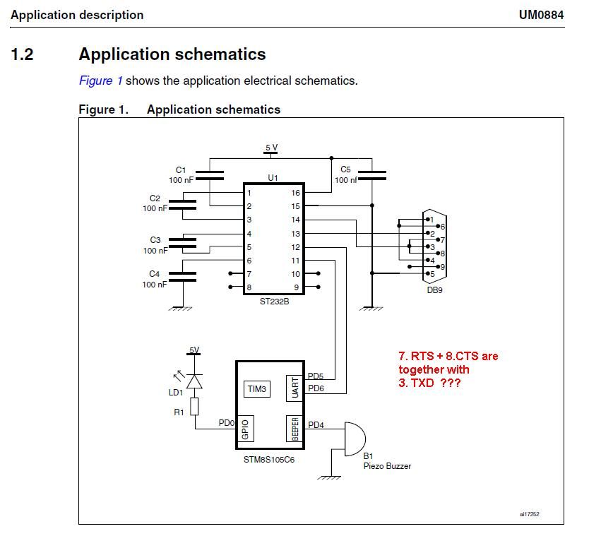

STM8 Discovery - Hyperterminal example application scheme
spiovan9
Posted on May 12, 2010 at 18:27
#hyperterminal
