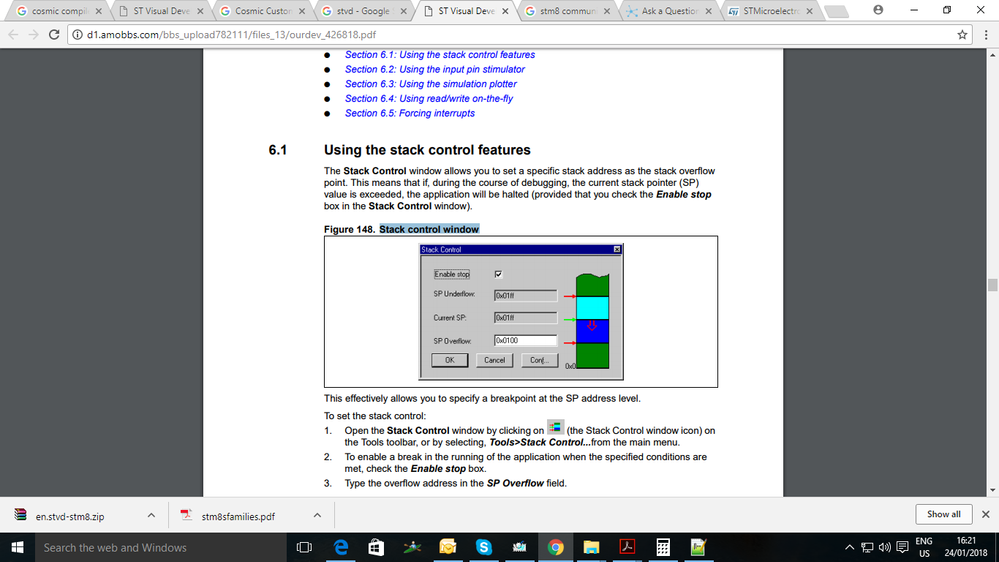

I am using STVD for development with cosmic compiler tool chain for stm8af5288 .
In stvd manual it is mentioned about stack control feature like below
but in stvd itself i am not able to locate any such window .
