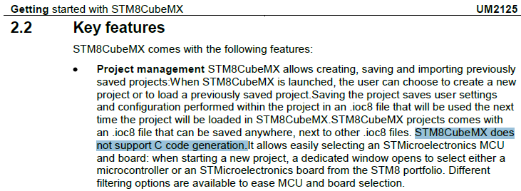

Isn't code generated by STM8cubeMX?
Jeong An
Posted on January 22, 2018 at 03:35
I use STM8cubeMX.
If possible, what should I do?
#stm8cubemx #stm8 #stm8-code-generate

Hello Jeong An,
Code generation feature is not supported by STM8CubeMX. This tool allows only to:
  • configure MCU's pins and assign them to peripherals in order to check if there are no conflicts
  • configure MCU's clock tree
  • estimate MCU's current consumption for given scenario
  • generate a report with above information
