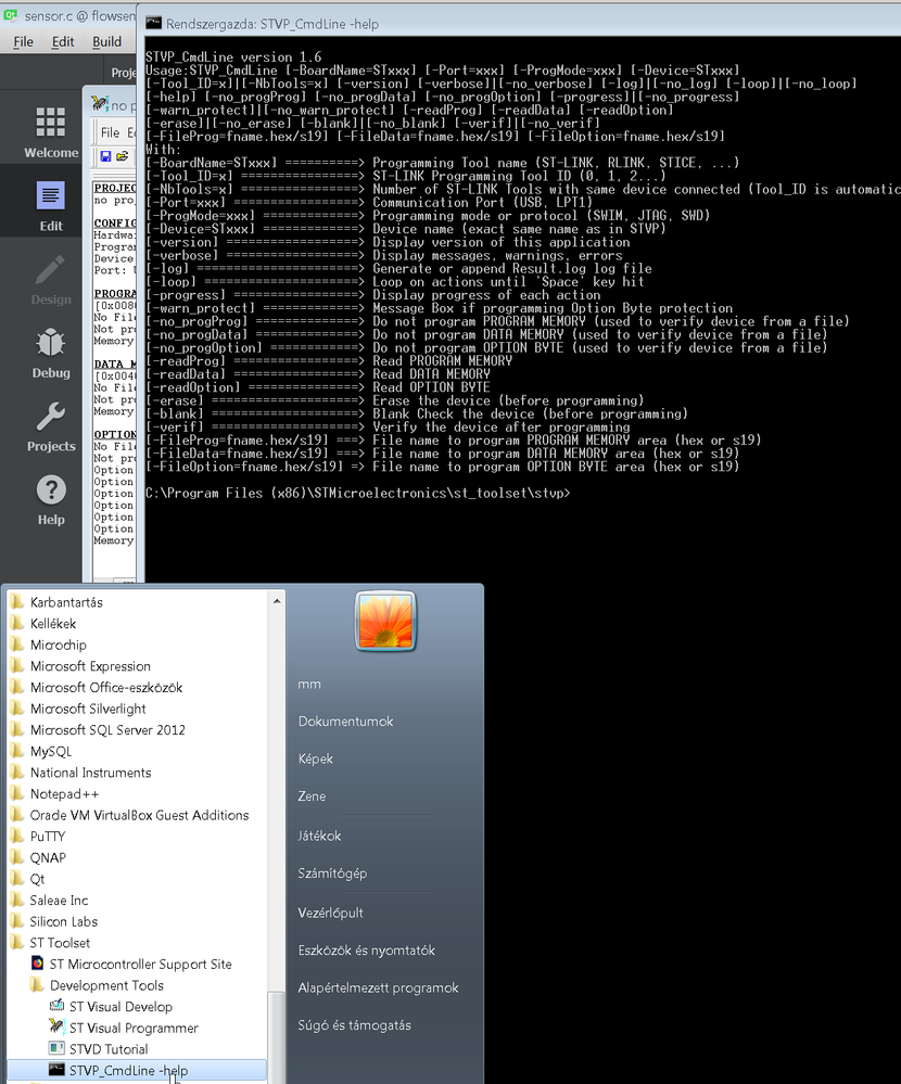

Is there any way to programm STM8 using a command line software ? I tried with ST-LINK_CLI but that is just for 32bits, no SWIM option

Or you can use the STVP_CmdLine utility which is shipped with the STVD:
