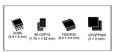

STM32C0 family has lowest packages sizes.
Example: STM32C011. Refer to the datasheet
and reference manual: RM0490
C0 family is intended to replace 8-bit MCUs.

I suggest STM32C0 family instead of STM8 which is an old 8-bit MCU.
Use STM32 MCU Finder tool to fine tune your selection.
