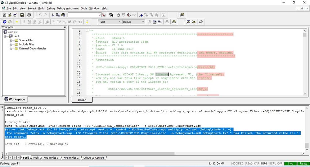

Hello Everyone,
actually iam new these STM8 microcontrollers and i have been trying the basic peripherals, in that process i have started with UART and i tried to compile all the Standard SPL library files and having this error please help me
-PFA-
Thanks

‎2021-03-16 3:47 AM
Hello ,
I go the same error. It is resolved by commenting the non handle interrupt in stm8_interrupt_vector.c file .
just comment the non handle interrupt written in stm8_interrupt_vector.c file .
You are getting this error because non handle interrupt is also defined in stm8_it.c /.h file
I am sending you the screenshot too.
please find the attachment.
please answer me if my solution resolved your problem.
thanks
Deoyani

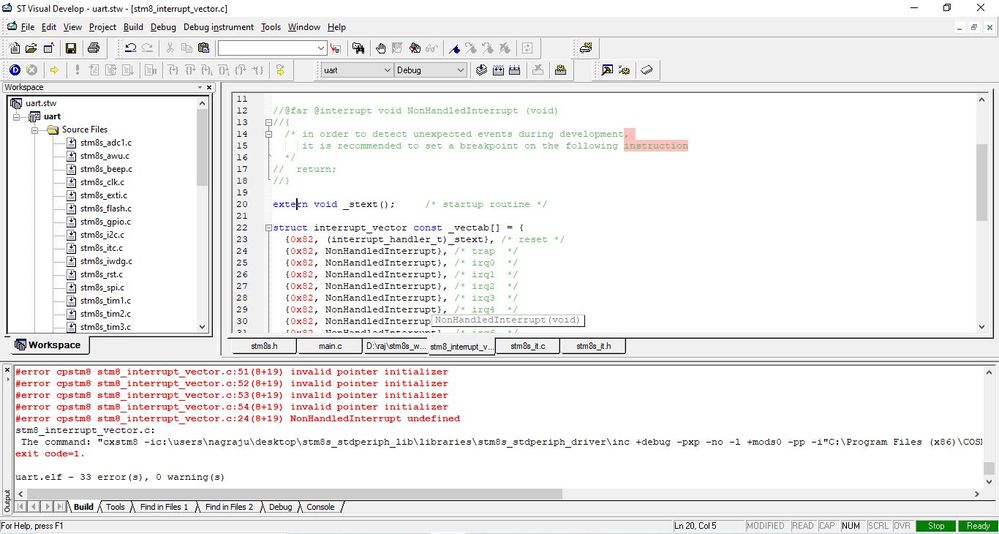

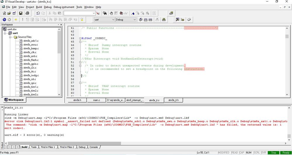

‎2021-03-16 12:43 PM
Hi DJosh,
Thank you very much for your support,
i have tried to comment "NonHandledInterrupt" from stm8_interrupt_vector.c file and iam getting this error(PFA), after that i have even tried uncommenting here and commenting the same function from stm8_it.c & stm8_it.h(at same time) then also iam getting the errors(PFA)
please help me

‎2021-03-18 1:35 AM
A few questions.
- did you follow the article I wrote on Instructables?
- every step of it?
- including the registration of the compiler(s) with Cosmic?
- what was the result of the compilation?
Because when I follow those steps I have a working setup....
