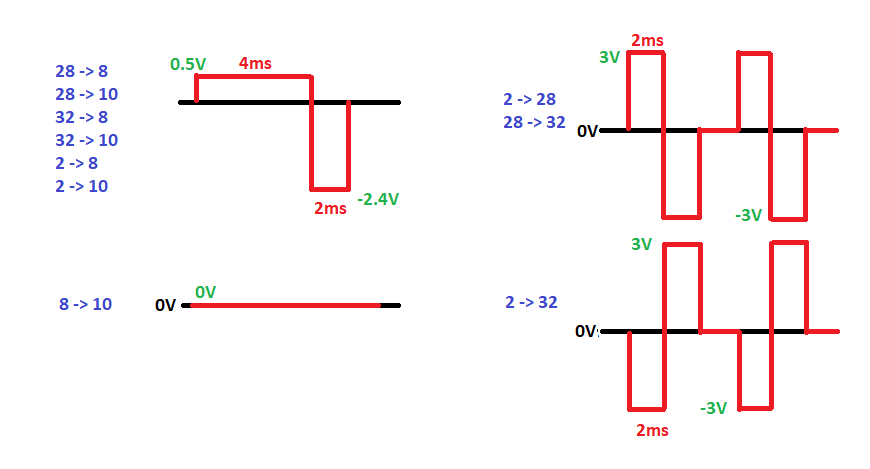

Rjohn.1
Hi, thanks very much for your help.
I have measured between each pin and found the following. I still don't understand it, but I am hoping you do!
Rjohn.1
To add to this, pressing the buttons just shorts the signal e,g 10->2 goes to zero if I press Button 3
Ozone
Principal III
Me neither ...
I would measure measure between pins and ground, negative voltages are irritating. I suppose there are no voltage below GND on the board.
>Fan Direction:
>Button 1 connects 10 -> 32
>Button 2 connects 8 -> 32
>Hatch up/down
>Button 3 connects 10 -> 2
>Button 4 connects 8 -> 2
>Button 5 connects 10 -> 28 (Sensor on/off)
>Button 6 connects 8 -> 28 (Power on/off)
Rethinking this, it seems pins 10 and 8 outputs, and pins 32, 2 and 28 are inputs.
Having set pin 10 and 8 to reverse levels ( 10 = H and 8 = L, or 10 = L and 8 = H), the buttons would connect one of those output levels the the respective input.
For sure the original designer could answer that questions immediately ... but I know how such things use to play out.
Perhaps respective output can then be used to drive an attached switch (power MOSFET ?) directly. The pin 8 / 10 outputs might additionally be pulsed.
I would review the schematics, or, if not available, deduce the relevant part (buttons and MCU connections) from a real-life board.
Rjohn.1
Thank you. Nothing is available unfortunately, however I am going to try optocouplers to connect the pins to see if I can mimic button presses.
I appreciate your thoughts!
