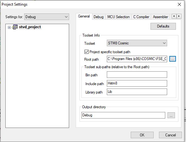

RomainR.
No need to set any path here in STVD Options Tab.
Check if Cosmic STM8 FSE is correctly installed in C:\Program Files(x86)\COSMIC in your computer and the path is need in Workspace Project Settings -> General Toolset Info Tab
0693W000007DJMZQA4.pngBest regards
