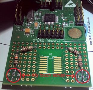

For STM8S103K3, I use STM8S discovery board by
remove STM8S105C6 and re wiring from STM8S103's pin to CN1, CN2, CN3 and CN4.
And connect pin like this
TL_Load is PE5
Point touch sence is PB0
LED is PC1
Not same as STM8S105C6 because it's easy to wire.
I guess this information may be usefull.
I not have oscilloscope but, I try volt meter at TS_Load.
On STM8S105C6 value is about 2 V.
but STM8S103K3 is 0 V.
Now, what can I do next ?

I found my problem.
My touch sence button make circuit unstable.
When I remove my touch sence. It working properly. (Only STM8S103K3, not on STM8S105C6)
Your guide helpfull to debug problem.
