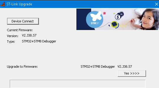

Your StlinkV2 must be a standalob product or an on-board product for a STM8 product. Perhasp you updated to a wrong firmware variant. Get into the update mode, start the updater and update to a SWIN enabled variant fitting to your dongle.

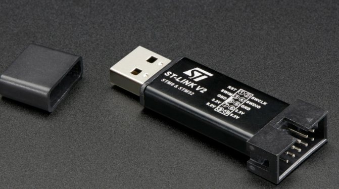

Thanks for reply,
My stlink v2 look like below.
0693W00000FE3PqQAL.pngcurrent version of my stlinkv2 is V2.J38.S7

Uwe Bonnes
Principal III
That is not a genuine STlink, but a clone. The cloner may have done anything and actually have broken swim functionality, or ST may have excluded cloned stlinks in recent firmware updates. Ask the real supplier. Double checking you setup is another thing to do,
