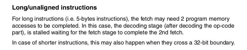

Hi. I am writing very time sensitive code on the STM8 mostly using assembly. However, I have noticed that sometimes adding one cycle of delay at one point in the code changing the timing of the whole code. I will explain in more detail to clarify. I have an interrupt which fires based on the a GPIO. I start reading the inputs. My code works, data read is good. I respond, but the timing is slightly off. So I add in a couple of nop cycles to fix it. The read is now broken. Keep in mind this is all a single sequential file of assembly to handle the interrupt. The processor is always in the WFI state when the interrupt fires. But somehow adding a couple of nops somewhere in the code causes everything to break (in terms of timing). I sure there is some explanation for this, but I have yet to find anything in any of the documentation. Any insight would be greatly appreciated.

The following snip is from the STM8 programming manual, pg. 22, Doc ID 13590 Rev 3:

I can't post the exact code but I will try to create something representative which will illustrate the behaviour I am seeing. In the mean time though I just want to clarify if there are any alignment requirements for this device. Do misasligned data or function accesses cause stalls in the pipeline or elsewhere in the architecture? Because I have not been able to find anything in the document alluding that it may be the case. Thanks.
Chris K
That explains it. Thank you.
