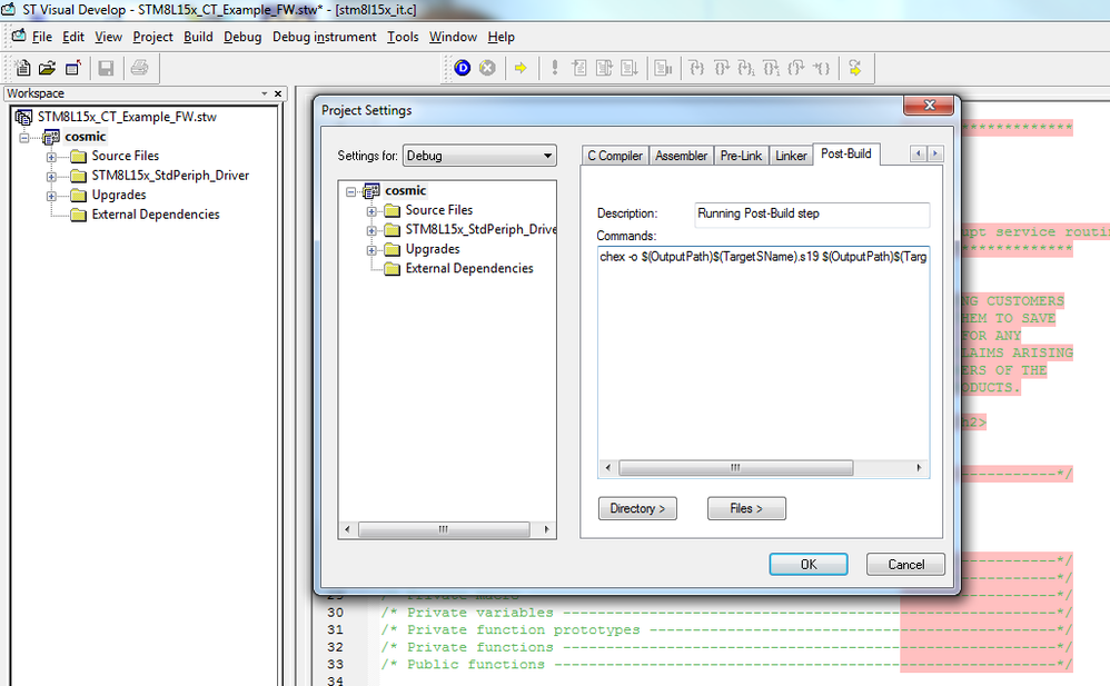

Hello,Can Any One Tell me how to get .hex file in stvd

If it is to generate the HEX file, it is in the project properties.
something like this:
This is an old project... it might look different with newer toolchains.
