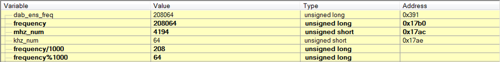

Hi all,
I'm developing an application (PROJECT) for a STM8S208RB (128k flash) t
hat was using around 100kB of flash and I
 have added recently a new library (LIBRARY) that has increased memory usage up yo 120kB
of flash
I had an issue because of this event that has been solved. More info in here:
https://community.st.com/message/188751
In the new library I have a function that reads a frequency in Hz (
IE: 208064
) and
then print it in MHz (IE: 208.064 Hz):
void disp_freq_mhz(void)
   uint32_t frequency;
   uint16_t mhz_num, khz_num;
   frequency = frequency_hz;                                                            // frequency_hz
is a global variable (uint32_t)
   mhz_num = (uint16_t)(frequency/1000);
   khz_num = (uint16_t)(frequency%1000);
   printf (' %03d.%03d MHz', mhz_num, khz_num);
The problem is sometimes
the division and/or modulus operations returns an erroneous value.
I have been debugging this error with STVD in the following way:
  • Known that frequency_hz == 208064, I have added the following code after khz_num assignation:
if(khz_num != 64 || mhz
_num != 208
   return;
  • I have placed a breakpoint in the  return; , so the execution stops when I get a bad division or modulus.
  • This is one reading of the variables involved in the function during one stop (the erroneous values are not always the same):
frequency_hz = 208064
frequency = 208064
mhz_num = 208
khz_num = 872                          // sometimes it is 640, but most of the time the erroneous value is 872
Result of printf -> ' 208.872 MHz '
Has anybody any idea of why is failing this arithmetic operations?
Thanks all of you in advance,
Guillermo,

    I'd printf(''%ld %ld\n'',  frequency, frequency_hz);  in the error case to confirm the input conditions, especially for the potential of the global variable being modified.
    This is the first thing I thought, that the global variable was being modified somewhere (IE: by an interrupt), but this is not the case, look at the image below:
  • dab_ens_freq is the global variable (frequency_hz in the first example)
  • frequency (local var) == dab_ens_frequency == 208064
  • frequency/1000 == 208
  • frequency%1000 == 64
  • mhz_num != 208
  • khz_num == 64
I can't compile the project with no-optimizations (because I get a ''not enough memory'' error), but with ''maximice execution speed'' (+speed) and ''minimze code size''(+compact) I get the same issue.
I've tried to disable and re-enable interrupts during the division and rest operations and it seems to fix the issue (or at least it reduces a lot the
repeatability
of the issue) but I don't understand why. So while I keep debugging the code I will use a workaround to at least avoid printing bad results.

Posted on March 12, 2018 at 10:27
Guillermo Corrales wrote:
I've tried to disable and re-enable interrupts during the division and rest operations and it seems to fix the issue ..
Best regards,
Guillermo.
make sure all your interrupt routines have the @svlreg keyword
@svlreg @interrupt myIntRoutine() ..
and see if that fixes the problem.
Posted on March 14, 2018 at 15:35
Wow, your suggestion fixed my problem!
I've taken a look to
@svlreg in the COSMIC user guide and I have found that it should be used when inside the IT floats or longs vars are used. This is my case since I added the new library, so now it makes sense with ITs disabled I didn't get the 'arithmetic' error.
Thank you so much Luca!!
