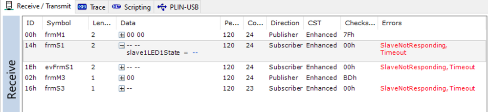

ZElya.1
Hello, Thank you for your response.
I connected it as you have said it seems that it works but...
I've downloded in it the project from the st website "STM8A-DISCOVERY boards firmware package, including LIN communication (AN4101)", but when I try to send and receive data from peaklin it gave me always "slave not responding, timeout".
I don't know if I am missing something, could you please help me.
Thank you.
Kind regards.
I will add here more information about the debugging, it seems that the data sent from the master is received correctly, and the function "USART_SendData8" responsible of sending frame from uc to the master is executed but i still get "slave not responding, timeout"
I am confused Idon't know where the problem is !
Thank you in advance
