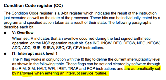

I test push and pop instruction,some issue confuse me. ​
push cc  #cc = 0
​when cc=0,and cc is push to stack,the value in stack is 0x28,this mean I1 I0 is set,why?
pop cc​   #cc=0
when​ cc in stack is 0x2b,after pop,cc change to be 0x3 ,this mean I1 I0 is cleared auto,why?
the behave is correct?Please help me.
thanks.​

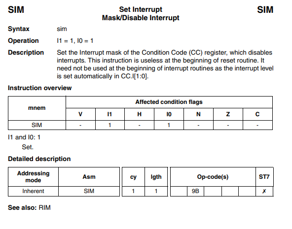

0693W00000D0JDGQA3.pngAre you sur that no interrupt happened while you're stepping?
Could you disable the interrupts using SIM and retest your code?
Disclaimer: I've never used STM8, I've just skimmed through PM0044.

I use STVD to debug, the program is not exsit ....
maybe this is caused by stm8-gdb.
