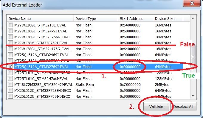

I have a STM32F769I-EVAL sitting on my desk ready to be loaded with it's first QSPI Flash XIP application. However, after I fire up the programmer and go to select the external loader I find there isn't one. There is one for the FMC NOR Flash, but none for the QSPI Flash.
The equivalent Discovery board has an external loader for their QSPI Flash. Unfortunately that external loader isn't compatible with the EVAL board (QSPI are on different pins).
I'm not really interested in building my own or extending other programmers. I just want something off the shelf that works.
Can someone tell me I haven't wasted my money on these boards?

you can find it in this image:

Thanks SLH,
They've left out the 'F' in the label (it should be ...STM32F7...). A whole day wasted because of a missing 'F' :face_savoring_food:
Thanks again.
