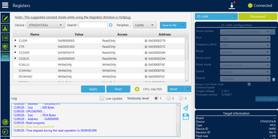

So if it stops, maybe you just have to "run" it again, see (whwn connected) in core/registers the green "run" :
cpu halted here (in my case on H7A3 also), if i just click on SWV.

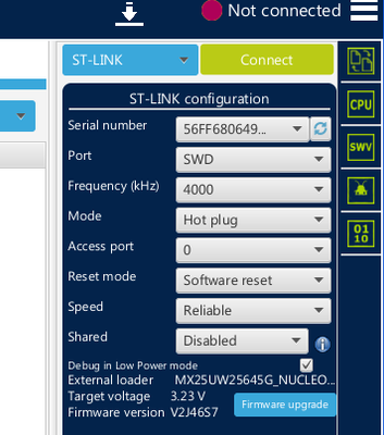

Try:
- set to hot plug , software reset
- connect
- then click SWV -> start   (works?)
it stops at the begininning of the code. it executes only HAL_Init and part of DMA_Init.
Even if i press stop and than start again it remains blocked. I've tried also with the configuration of hot plug, but nothing changed
Did you try exactly this sequence ?
power cycle the board; if one time click on SWV and got it "blocking", can only full reset by power off;
then try: in CubeProgrammer:
- connect  (not click SWV !)
- if connect ok, target should still run fine ; then click SWV -> start (works?)
I've tried exactly that sequence.
It not works
