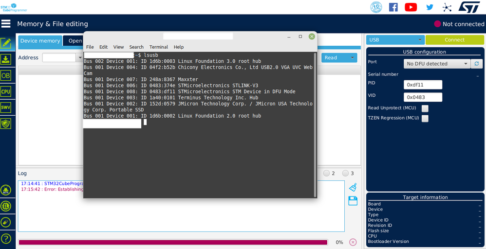

0693W00000WL7ZIQA1.pngHi,
USB DFU did not work in STM32CubeProgrammer in Linux. The programm did not detect the usb port. But it works faultless in STM32CubeProgrammer in windows.
I tested with STM32CubeProgrammer V2.10 and 2.12, same results.
I have linux mint 20.3 Luna

Can it be a permission problem? Do you have udev rules to give access to non-root apps?

same on my linux (MX18) ; stlink working fine; dfu mode seems not "known device" to system,
dmesg shows:
0693W00000WLF51QAH.pngso cannot enumerate.

Yes it causes permission. It worked when I ran program with sudo. I will try to set the udev rule.
