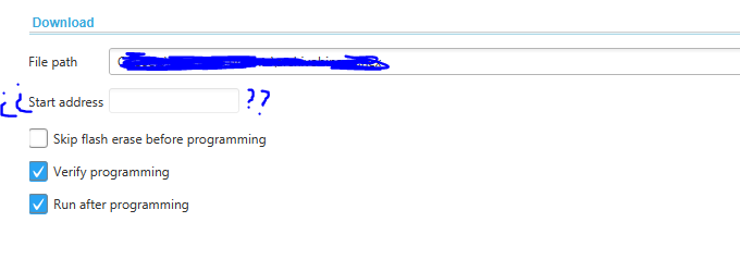

STM32CubeProgrammer. STM4L4x5. How to download binary or hex file with start address that not equal 0x8000000. For example, 0x807F000. ST-LINK_UTILITY does it without problem.

What type of file?
A .BIN should let you set this.
A .HEX/.ELF has addresses in it, make a .BIN if you need to relocate it some place else.
It was a very stupid thing, i named my files as .hex instead of .bin, now i have different problems but not thisome :D
