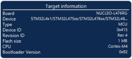

I'm using STM32CubeProgrammer v2.12.0 (according to the updater it is the latest at this time) and I want to enable Dualbank on my Nucleo board.
The Nucleo board is a NUCLEO-L476RG and is correctly recognized as such:

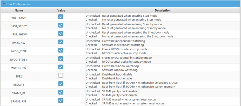

However in the Option bytes -> User Configuration tab, the DUALBANK option is missing:
The BFB2 option is present though, but as I understand it:
  • DUALBANK controls whether or not the flash is divided into 2 banks
  • BFB2 controls which bank to use in case DUALBANK is set
Am I right ?
In any case, shouldn't DUALBANK be shown since it is user configurable ?

Hello @SDpy.1​,
According to the reference manual, section 3.4 FLASH option bytes, DUALBANK Option Byte is present on 512 KB or 256 KB Flash memory devices. However, STM32L476RG MCU is 1MB Flash.
BFB2 controls dual bank boot not bank selection. Please refer to the reference manual or this post for further explanation.

Hello @SDpy.1​,

  1. For flash memory size <= of 512kB, we need to set the DUALBANK option byte to enable dual bank implementation.
  2. For flash memory sizes > than 512kB, we can use the BFB2 option byte to configure the boot bank selection. If we need to run firmware from bank2 then BFB2 option byte need to be configured, or the boot will be always from bank 1.
  3. FB_MODE in SYSCFG can be used in run time to swap flash banks if needed.
BFB2 flag essentially triggers the attempt to boot from Bank2 on reset. See AN4767 section 3.1.3 BFB2 flag in user option bytes.
It is important to keep BFB2 flag set when there is no code in Bank1, thus being safe in case of unexpected power failures.
With BFB2 set, the system bootloader is activated to evaluate if a code is present in Bank2 and then puts it in control, as explained in AN2606. Then, the firmware has to detect that the code in Bank1 must be replaced, and that the process is running from Bank2.
Hope this answers your questions!
