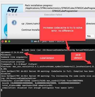

Hello, STM32cubeprogrammer fails to install, can you assist?
M1 Macbook Pro (Ventura 13.4.1)
Java Version = 1.8.0_381
STM32CubeProgrammer = 2.14.0

Hello @SamHansen42 ,
Thanks for your feedback,
Please try one of the following solutions:
1- Install CubeProgrammer using the command:
sudo xattr -cr ~/SetupSTM32CubeProgrammer-macos.app
2- In case you used the .exe installer (sudo java -jar SetupSTM32CubeProgrammer-2.14.0.exe.) and the popup occurs during the install indicating the following:
cp: en.stm32cubeprg-mac_v2-14-0/../../../jre: No such file or directory
Continue Installation?
Continue the installation and copy the downloaded jre folder manually into the CubeProg install folder. To do so, please follow the steps below:
- Copy the jre folder from the downloaded en.stm32cubeprg-mac_v2-14-0
- Open CubeProgrammer install folder
- Right click on STM32CubeProgrammer.app and select "Show Package Contents"
- Paste the jre folder
3- After the install, if CubeProgrammer couldn't be launched via GUI, please try to lanch it via CLI as follows,
- Navigate to the /Applications/STMicroelectronics/STM32Cube/STM32CubeProgrammer/STM32CubeProgrammer.app/Contents/MacOs/bin/
- type the command:
java -jar STM32CubeProgrammer
- If the jre folder exists in CubeProgrammer install folder, type the following command:
../../../jre/bin/java -jar STM32CubeProgrammer
I hope this helps!
Sara.

SamHansen42
TLDR: DO STEP 2 OF SOLUTION PROVIDED BY SARA, INSTALL THE EXE AND MANUALLY COPY THE JRE AS INDICATED
1. When entered this command I got no response from terminal.
2. OK, performed
I would like to point out for other users, somehow I had a copy of .app directly under Applications/STMicroelectronics/. This was possibly installing using the .app instead of .exe. This caused confusion when performing step 2, i copied the jre here. Now I got rid of this. when you copy the jre I think you should copy to the .app file inside Applications/STMicroelectronics/STM32Cube.
I did this of step 3, but then realized my mistake above and corrected that. App starts
