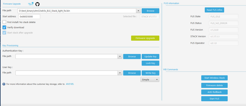

I am using STM32WB55RG board and trying to run example code BLE_HID When I connected via ST-Link using the STM32cubeprogrammer tool, the binary I wanted was uploaded well as shown in the picture below, and I checked the Bluetooth operation by executing the BLE_HID code.

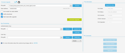

However, when connected via USB, as shown in the picture below, the binary I want is not upgraded and the tool is shut down.
Occasionally, the binary is uploaded, but in that case, the WB command buttons are disabled, so I can't press Start Wireless Stack, so even when I run the BLE_HID code, it doesn't work well.
![dami_1-1691650721780.png dami_1-1691650721780.png](https://community.st.com/t5/image/serverpage/image-id/52308i1977EC31A2F07441/image-dimensions/519x223/is-moderation-mode/true?v=v2)

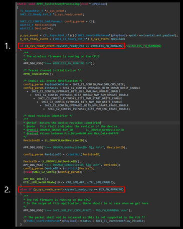

In the BLE_HID example code, MX_APPE_Init(); When the function is executed, when the static void APPE_SysEvtReadyProcessing(void * pPayload) function in the app_entry.c file is executed, it is divided into Wireless_fw_running or FUS_fw_running.
When the binary is upgraded using USE as a soft loader, fus_fw_running is always executed.
I want to run it with wireless_fw_running.
