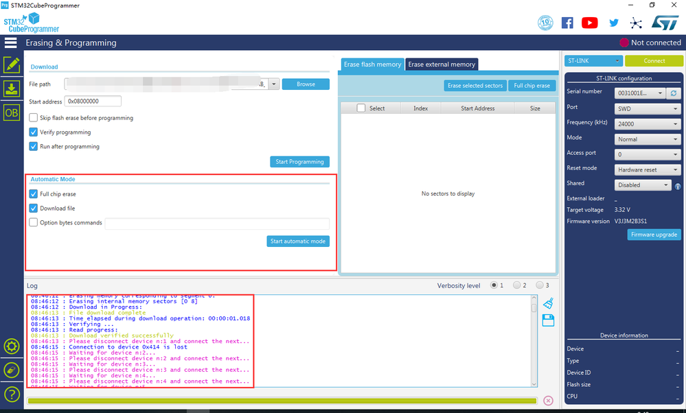

STM32CubeProgrammer Automatic Mode not working properly!
myang.17
​When the first one download complete, disconnect it.
 The programmer will tip "Waiting for device n:x... Please disconnect device n:xx and connect the next....", until the next device cennect!
Can anybody help me?

08:46:11 : Starting Automatic Mode...
08:46:11 : MASS ERASE ...
08:46:12 : Mass erase successfully achieved
08:46:12 : Memory Programming ...
08:46:12 : Opening and parsing file: STM32F103RB.bin
08:46:12 : File : STM32F103RB.bin
08:46:12 : Size : 16616 Bytes
08:46:12 : Address : 0x08000000
08:46:12 : Erasing memory corresponding to segment 0:
08:46:12 : Erasing internal memory sectors [0 8]
08:46:12 : Download in Progress:
08:46:13 : File download complete
08:46:13 : Time elapsed during download operation: 00:00:01.018
08:46:13 : Verifying ...
08:46:13 : Read progress:
08:46:13 : Download verified successfully
08:46:13 : Please disconnect device n:1 and connect the next...
08:46:15 : Connection to device 0x414 is lost
08:46:15 : Waiting for device n:2...
08:46:15 : Please disconnect device n:2 and connect the next...

Hi @myang.17​ ,
Thanks for your feedback.
We are aware of this issue and it will be fixed in next STM32CubeProgrammer 2.2.0 planned for Sptember 2019.
in the meantime you can try:
-Unplug board every time if possible(not just change the chip)
- Or use STLink utility.
Best regrads,
