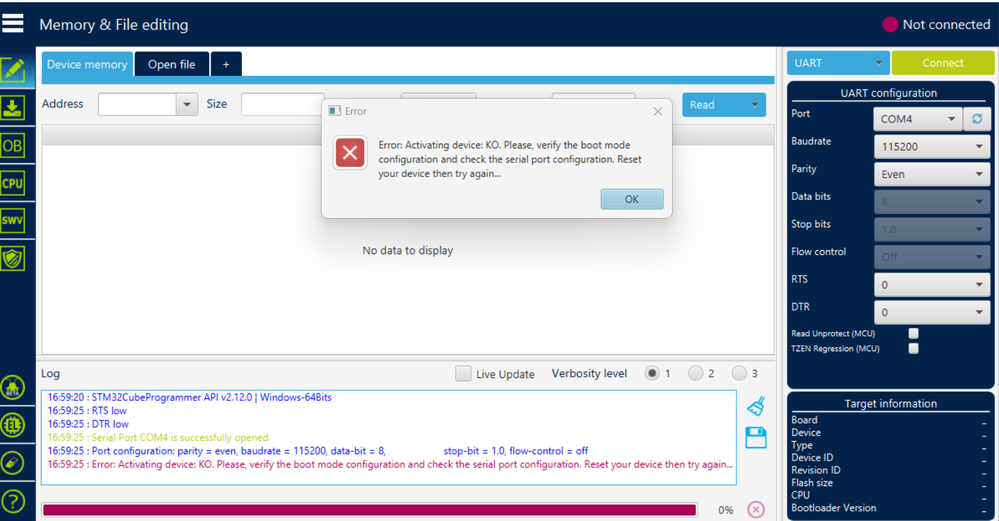

I am using an open bootloader from st for the firmware update in my project. Bluetooth module is connected to MCU via UART, which is configured to communicate with the computer via SPP protocol. Basically, I am able to communicate with the MCU like a serial com port.
I want to know if I can use the stm32cubeprog UART feature to upload the firmware on the MCU running ST Open Bootloader?

If im not mistaken CUBEPROG will expect an USB vitual com port (COM), is your bluetooth creating a COM port when paired?0693W00000Y9h4FQAR.png

@Javier Muñoz​ I already have a COM port. I can communicate with the device via putty, tera term or similar serial terminals.
I haven't fully implemented open bootloader yet. However, at this point whenever I try to connect to the device via stm32cubeprog it throws the following error.
0693W00000Y9hDgQAJ.pngIn addition, I am not sure what baud rate to set. I don't think the baud rate is applicable to Bluetooth connection. In putty, communication is okay irrespective of the baud rate.

I would try it with the factory programmed bootloader first
Thats a good question, i would try 115200 as it is standard.
Perfect then

Its a nice thing to have as a sanity check, to make sure cubeProgr and bluetooth SPP work as expected.
>>I cannot change boot pin to access it
https://stackoverflow.com/questions/73390378/stm32g0b1ce-can-the-boot-option-bits-be-used-to-jump-to-system-bootloader
