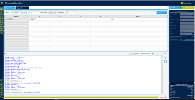

Hi. I made a custom PCB with an STM32C031 microcontroller. However, I am unable to program it because it is recognized as 0x466. The problem occurs in both STMCubeProgrammer and the IDE. I checked 2 st-links with the latest firmware.

I can see the device memory, but the device type/id is incorrect.

Hello @Jin454 ,
I tried connecting an STM32C031 and the device ID is correctly displayed on my end.
Could you please try reading data at @ 0x40015800 as shown below and let me know the value?
Thank you in advance,
Maryem.
