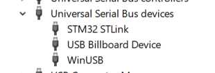

I am not able to see STM Cube Programmer com port?
Vmere.1
Senior
0693W00000HqfdfQAB.pngI want to flash my software to STM32 and I want to see the com port.
So I went to device manager and I found out this
0693W00000HqfenQAB.pngWhat should I do here?
If you are using the SWD connection, you should put "SWD" there. It is not a COM port.

Thank you very much. It worked. (Sorry for very late reply)
