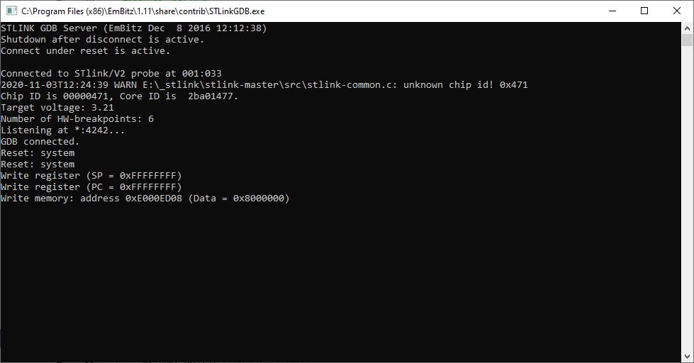

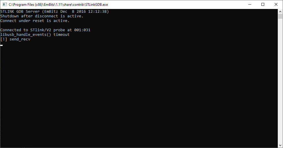

I migrated to L4Q5 MCU and the Embitz debugger is not able to see the Target. I have pointed the build options to the new linker file. However, I feel like I need to translate STM32CubeProgrammer settings to the Embitz debugger options. What do I need to do to make it work?0693W000005AEn7QAG.png

I'd expect there is a more current STLINK GDB Server in CubeIDE, perhaps pull and test that one.

I have made some progress by finding the right .svd file. However, I still have some problems with the debugger. It seems that the chip ID is unknown somewhere?
The assert provides the source file and line for the test.​ Modify and recompile the indicated file, or find updated file with fix.
I cannot find stlink-common.c ...? I do not have an E: drive...
Where would that be?
Not your hard drive
https://github.com/stlink-org/stlink/blob/develop/src/common.c#L1327
Perhaps find yourself a copy of the STLINK GDB Server that isn't 4 YEARS OLD!
Okay thanks for the info! How do I set it up? I copy the common.c to a local folder? or do I copy the link somewhere in my Embitz configuration? (sorry never had to deal with this yet)
