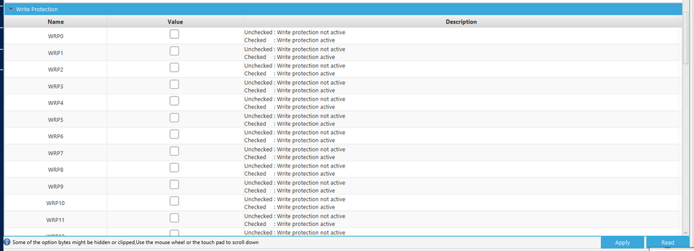

Hi, I have a question about "Write Protection" in Option Byte. Is it possible to write protection only for one page instead of one block? In STM Programmer I see only 64 blocks (WRPx). One block corresponding to 16 pages (4096kB of memory).
KPode.1

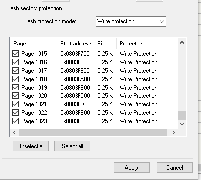

0693W00000NrAalQAF.pngI would like to choose one page like in STM32 ST-LINK Utility:
2 REPLIES 2

Welcome, @KPode.1​, to the community!
Which STM32 are you talking about in the first case and which in the second?
Regards
/Peter
KPode.1
I have already found an information in datasheet about writing protection with 4Kbytes granularity for STM32L151xC. I used different STM32 in my comparison, like you said.
