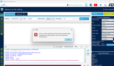

Error: No STM32 target found! If your product embeds Debug Authentication In stm32 Programmer

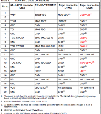

In the datasheet for ST-link V2, 2x10 20pin connector.
To use JTag or SWD flash, at lease VDD, JTMS, JTCK, GND, JTDO, NRST are need.

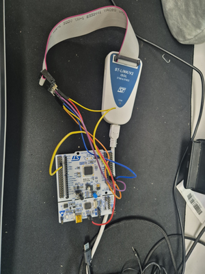

So, I connect wire to St-link V2 pin to Nucleo Board, it is not work.
How can I do that?

Hi, I want to flash using external ST-Link/V2, not using nucleo internal ST-LINK/V2 module like this.

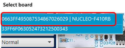

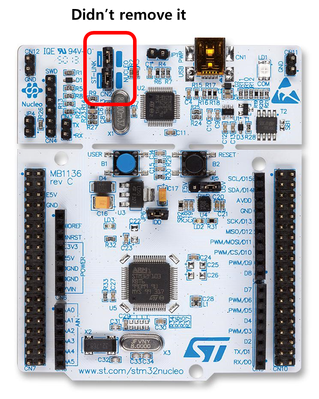

With the current setup, you have two ST-LINKs in parallel, which of course cannot work. You must remove the two jumpers from CN2 so that the embedded ST-LINK/V2-1 is disconnected from the target.
BTW: there is no NUCLEO with STM32F410CBT6, you probably mean the NUCLEO-STM32F410RB?
Please note that the target currently gets its HSE from the MCO of the ST-LINK/V2-1. If you want the target to be independent and have its own HSE, you must:
  • Open SB50
  • Close R35 and R37 or fit them with 0-ohm resistors
  • Fit X3, C33 and C34
(see also the schematics, page 3)
