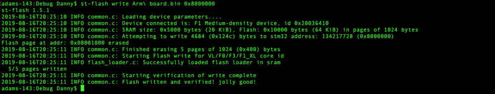

Good afternoon, I was trying to debug a program on my new stm32f103C8T6 chip using the st-link v2 programmer, but i always get the same error : Error: failed to erase memory
I have tried the procedure with multiple boards so i guess that the problem is software, here is the full console output :

@Bob S​ finally found the problem :
I went on Windows and attached the st link v2, started the program st-link and disabled 'read out protection' from configuration bits, once i did that, I could write freely any program on the flash using st-link command on mac OS and booting on System Memory (Boot<1:0> = 01).

"Error! Failed to read target status"
I think that you must disable 'read out protection' in st-link utility, had the exact same problem
AHofm
ooooooh, thanks, can you little bit direct me where to set it.
Thx Ant
ABouk
try 'configuration bits', it's there, after having disabled it erase the flash memory and retry debugging using stm32cube if you want

I had something that looked quite similar using CubeMX IDE and a "Blue Pill":
  • device with MBytes instead of KBytes
  • Error during Erasing
I dowloaded Stm32Cube Programmer and discovered that RDP - Read Out Protection was set. So Flash Memory was read-protected. Unchecking this protection solved my issue (both with Stm32Cube Programmer and CubeMX IDE).
