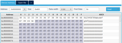

Hi
I am trying to get a custom external loader working on a STM32L562VET with a MT25QL128ABA attached over QuadSPI. I have followed this tutorial: https://www.st.com/content/st_com/en/support/learning/stm32-education/stm32-moocs/external_QSPI_loader.html
and after some modifications, I managed to successfully run the main_test code and everything seems to work fine. I can also see the data in the memory viewer in the STM32CubeIDE.
I then continued to build the *.stldr which also seem to work fine. However when I import it in STMCubeProgrammer v2.15.0, I can erase certain sectors or the whole chip. But if I try to download a .bin file (256Bytes random ASCII), I get the following error messages:
15:39:48 : Error: failed to download Segment[0]
15:39:48 : Error: failed to download the File

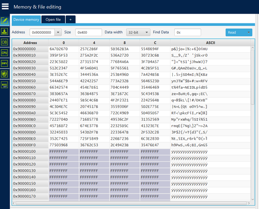

If I go back to the memory viewer, I can see that the data was successfully written to the flash despite the error message. What could be the problem here?
I already tried with STMCubeProgrammer v2.6.0 but get the same error message.
This is the log I get:

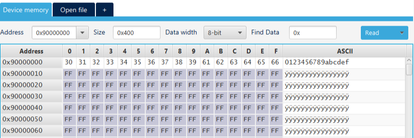

I made some more experiments and it seems like the data is not correctly written to the flash from CubeProgrammer. When I write a bin file containing 16bytes "0123456789abcdef", it actually works and I get the message "file download complete" and the memory looks right:
However, when I download a bin file containing 17bytes "0123456789abcdefg", I get the mentioned error message and the 17bytes get correctly written including 3 garbage bytes (randomly):

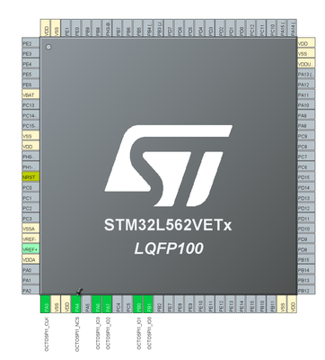

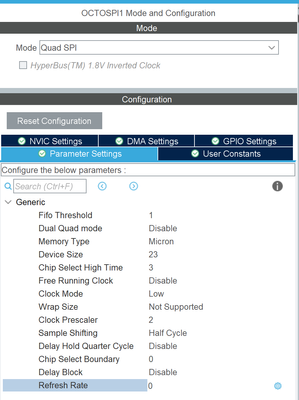

Here's my pin Cube config:

‎2024-03-15 12:30 PM
Tentative L5 build from my OSPI forks.
PA3:AF10 CLK
PA4:AF3 NCS
PB1:AF10 D0
PB0:AF10 D1
PA7:AF10 D2
PA6:AF10 D3

Unfortunately, this did not work. However, thanks to the debug UART output, I managed to find the issue. There was something wrong with the de-initialisation of the OSPI in the write function. No idea why this only happened when writing the second time.
However the behavior of CubeProgrammer is still a bit mysterious to me. Like mentioned above, writing a 16byte bin file worked correctly because it was written only once. Here the log of my UART output:
Initialisation
LOADER_OK
Write: 0x90000000 0x10 0123456789abcdef
LOADER_OK
(Write: [Address][length][data])
However a 17byte bin file gets written twice and the length transmitted is not correct and thus there is some garbage data:
Initialisation
LOADER_OK
Write: 0x90000000 0x14 0123456789abcdefgâ–’â–’â–’
LOADER_OK
LOADER_OK
Is this a bug or a feature?
