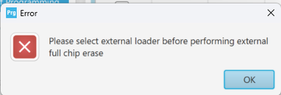

I created an external flash STLDR file for my board, with STM32H750VB chip and W25Q64 QSPI FLASH. After copying the STLDR file to the cubeprographer directory, it can perform normal external flash read/write and sector erase functions. However, when selecting full chip erase, the cubeprographer prompts me "please select external loader before performing external full chip erase". But I am sure that my code contains the correct int MassErase (void) function, and I used the readelf command in Ubuntu environment to read the STLDR file I created, which also includes the MassErase function. But it seems that this function cannot be correctly detected by the cubeprographer. How can I locate the cause and solve this problem?

STM32CubeProgrammer GUI External Loader Full Chip Erase Failure Issue
I'm experiencing an issue with External Loaders created using CubeIDE when using STM32CubeProgrammer GUI:
Problem Description:
  • STM32CubeProgrammer GUI fails to execute "Full chip erase" with custom External Loader
  • Error message: "Please select external loader before performing external full chip erase"
  • Issue occurs on both STM32CubeProgrammer v2.19.0 and v2.20.0
However, CLI works perfectly:
STM32_Programmer_CLI.exe -c port=SWD freq=4000 -el .\MyExternalLoader.stldr -e all

Mass erase ...
Mass erase successfully achieved
  • CLI executes mass erase successfully
  • Flash memory is properly erased to 0xFF (verified)
My Analysis: I suspect this might be a compatibility issue between STM32CubeProgrammer GUI and External Loaders built with CubeIDE (GCC toolchain). Official ST External Loaders appear to be built with IAR Embedded Workbench for ARM (EWARM), which may create binaries with different structures that the GUI specifically expects.
Could this be a bug where STM32CubeProgrammer GUI only recognizes MassErase functionality in EWARM-built binaries?
