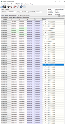

I'm currently working with the STM32G474RE microcontroller and aiming to transition from the standard dual bank mode to the single bank mode.
However, I've encountered an issue during this transition. When switching the bank mode, the read width changes from 64 bits to 128 bits. This change in read width is leading to data misalignment problems so when the HAL launch function responsible for loading and resetting the option byte after the bank mode switch is called, the program seems to hang, suggesting possible damage.
Could you please provide guidance on how to address these issues and ensure a smooth transition to single bank mode without causing data misalignment or program damage?

I am experiencing the same missalignement when viewing the flash in the stm programmer. This misalignment seems to be related to loading changes to the option bytes with HAL_FLASH_OB_Launch rather than switching between dual-bank or single-bank modes. For example, the issue persists after setting write protection, read protection or setting the nboot bits which all require loading the changes to the option bytes using HAL_FLASH_OB_Launch.
