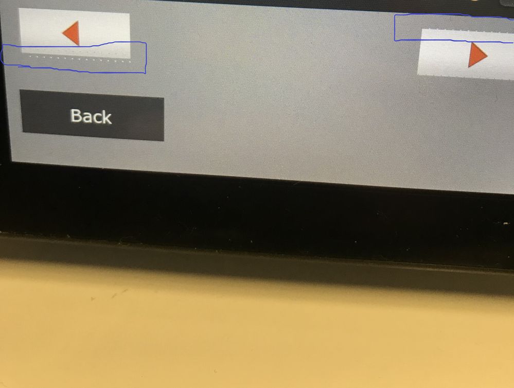

I use same flash memory ( at25sf128) in my project and I can read data from flash correctly, I checked it. However, The images does not have correct view on LCD.
Have you ever had this problem?
