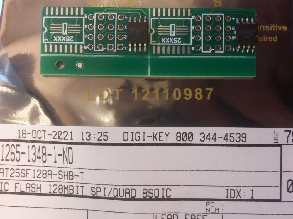

I used MT25QL128 flash memory in my project. This product was obsolute then, I decided to use AT12SF128 flash memory instead of MT25QL128 . Now, I use STM32 Cube Programmer and can not write external memory . Program give "memory edition verification error".
help please?

I wrote ".stldr" file for MT25QL128. Pins are quadspi IO pins for my own microcontroller(STM32F746). I arranged gpio settings for these pins in loader code. It work with MT25QL128 . However, these configurations do not work for AT12SF128. Also, pins are same because pcb board is not changed. I can do chip erase and sector erase but I cant read and write in external memory.
Hm, the AT25S128 seems to use a rather conventional instruction set. As long as the block protection bits in status register remain cleared, loader code for MT25QL128 should work after some simple modifications:
  • If ID is checked, it has to be adjusted, furthermore 0x9F works only in 1-line mode.
  • Write Enable only in 1-line mode
  • Read Status Register only in 1-line mode
  • If Quad I/O Fast Read 0xEB is used: instruction in 1-line, address and data in 4-line mode, and one extra M byte after address has to set up properly (via one alternate byte, or maybe one extra dummy byte with all pull-ups enabled or all pull-downs enabled)
  • Quad Page Program 0x32: instruction and address 1-line, data 4-line
  • no configuration required (i.e. no QE bit, no Enter Quad Mode)
In a sense, the AT25S128 is much simpler than the MT25QL128 as there is no configuration required/possible (no QE bit, no Enter Quad Mode). Since chip erase and sector erase works, all boils down to the *different* 1-line/4-line mix for read/program and the extra M byte for read.

Microcontroller is STM32F746IGT , then I use PB2(CLK), PF8(IO0) , PF9(IO1), PF7(IO2), PF6(IO3) , PB6(CS). I used default STM Loader code. I changed this code for these pins. Now, I make chip erase and sector erase. But, I do not read in memory, show in picture. My read command is "0x6B" .
I have progressed on the subject but could not reach the result.
