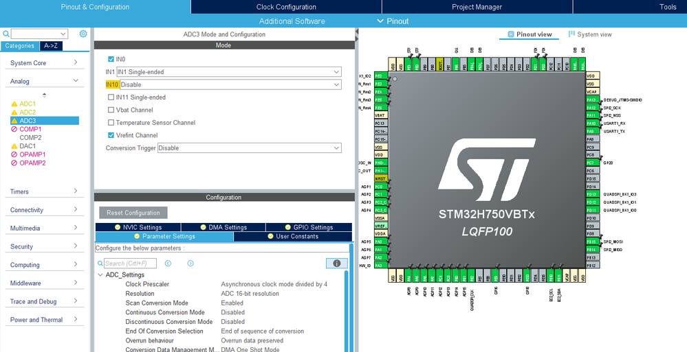

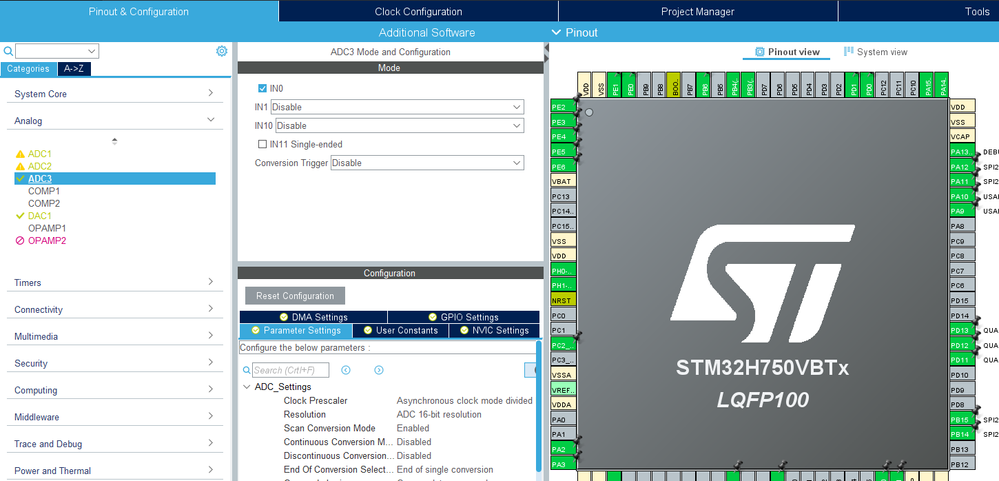

why are vbat, vrefint and temp ADC3 channels on STM32H7 no longer available on the latest CubeMx version? I'm I missing another conifguration to make them available?
‎2020-01-31 6:06 AM
screenshot from an .ioc file created with an earlier version of CubeMx
CubeMx version 5.30
screenshot from an .ioc file created with CUbeMx version 5.5.0

‎2020-01-31 6:09 AM
​Hello @Sebastiain Fernandez​ ,
Issue has been fixed , the fix will be available in the next release.

‎2020-01-31 6:46 AM
Hi I just found that the problem is in fact related to the STM32CubeH7 firmware package 1.6.0.
I downgraded to version 1.5.0 with CubeMx 5.5.0 and the ADC3 vbat, temp and vrefint channels are available
