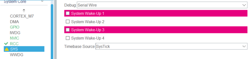

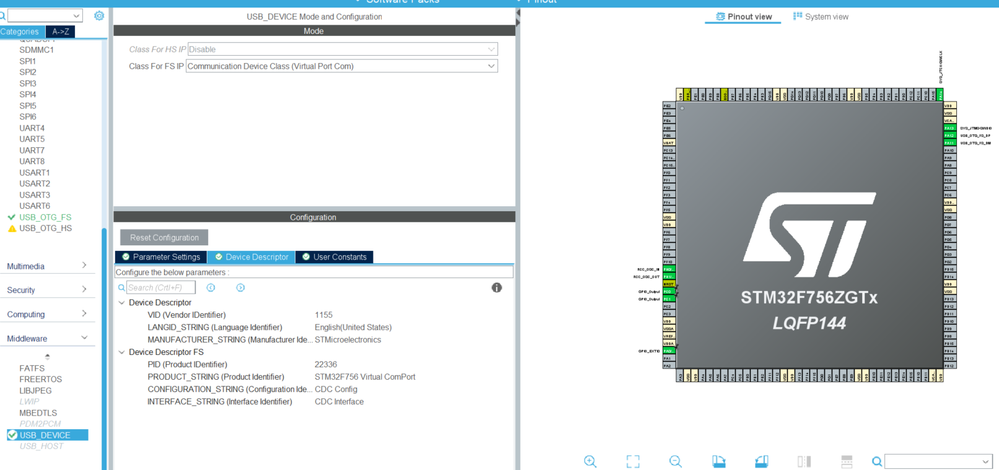

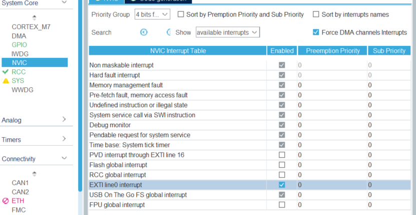

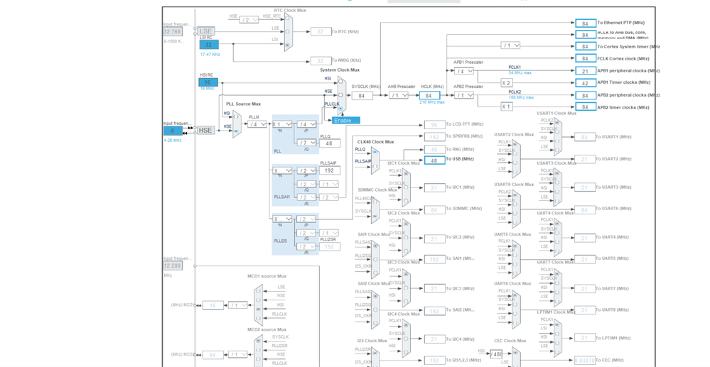

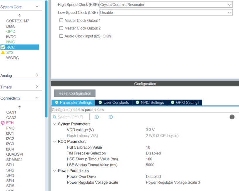

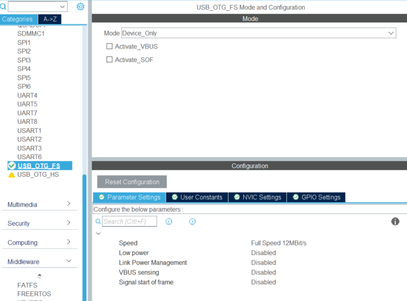

I cannot communicate with my computer. I detect the port but in debug mode, I see that the OTG_FS_IRQHandler interrupt is triggered regulary when I send data on my computer.
I did the same thing with my dicsovery card F411, it works. But with nucleo F756, it doesn't work. I'll give you all the parameter I set in picture linked.

The fact that OTG_FS_IRQHandler is called is a good sign.
You have an example of VCP implementation in the F7 software package, so you can compare what is missing:
STM32Cube_FW_F7_V1.16.0\Projects\STM32756G_EVAL\Applications\USB_Device\CDC_Standalone

In fact, my program work well. It works well on windows 7 but not on windows 10, but normally, we don't need driver?
‎2021-09-29 9:17 AM
You don't need it, normally.
But driver is here:
