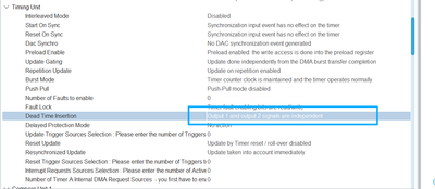

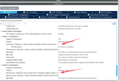

Two independent outputs have been configured in HRTIM, but the trigger source for the second output cannot be set, indicating that it must be 0.
 HRTIM中已经设置了两路独立输出,第二路无法设置触发源,提示必须是0

Hello @xiaowenbin
Thank you for posting!
This is a known issue and has been already reported to dedicated team as discussed under this thread: Solved: HRTIM configuration when updated to 6.16.1 CubeMX - STMicroelectronics Community
