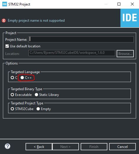

Note: If you are select "c++" as target language, the bug is gone...0693W000008wYBfQAM.jpg
Do we have a proper work around without selecting c++ as he Target Language?
Fact is TouchGFX usage is requiring C++
