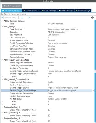

I am using hrtim to trigger the adc, but if the regular channel is not triggered with hrtim, it doesn't go into the interrupt of the ADC properly, I checked a lot of information and didn't find a solution, here is my code and cubemx configuration:
NVIC_SetPriority(HRTIM1_TIMC_IRQn, NVIC_EncodePriority(NVIC_GetPriorityGrouping(),0, 0));
NVIC_EnableIRQ(HRTIM1_TIMC_IRQn);
NVIC_SetPriority(HRTIM1_FLT_IRQn, NVIC_EncodePriority(NVIC_GetPriorityGrouping(),4, 0));
NVIC_EnableIRQ(HRTIM1_FLT_IRQn);
LL_HRTIM_SetSyncInSrc(HRTIM1, LL_HRTIM_SYNCIN_SRC_TIM_EVENT);
LL_HRTIM_ConfigDLLCalibration(HRTIM1, LL_HRTIM_DLLCALIBRATION_MODE_CONTINUOUS, LL_HRTIM_DLLCALIBRATION_RATE_3);
LL_HRTIM_ConfigADCTrig(HRTIM1, LL_HRTIM_ADCTRIG_2, LL_HRTIM_ADCTRIG_UPDATE_TIMER_D, LL_HRTIM_ADCTRIG_SRC24_TIMDCMP2|LL_HRTIM_ADCTRIG_SRC24_TIMDRST);
LL_HRTIM_SetADCPostScaler(HRTIM1, LL_HRTIM_ADCTRIG_2, 0x0);
LL_HRTIM_ConfigADCTrig(HRTIM1, LL_HRTIM_ADCTRIG_3, LL_HRTIM_ADCTRIG_UPDATE_TIMER_D, LL_HRTIM_ADCTRIG_SRC13_TIMDCMP3|LL_HRTIM_ADCTRIG_SRC13_TIMDCMP3);
LL_HRTIM_SetADCPostScaler(HRTIM1, LL_HRTIM_ADCTRIG_3, 0x0);

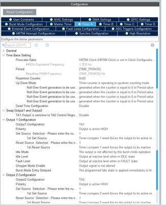

LL_HRTIM_TIM_SetPrescaler(HRTIM1, LL_HRTIM_TIMER_A, LL_HRTIM_PRESCALERRATIO_DIV1);
LL_HRTIM_TIM_SetCounterMode(HRTIM1, LL_HRTIM_TIMER_A, LL_HRTIM_MODE_CONTINUOUS);
LL_HRTIM_TIM_SetPeriod(HRTIM1, LL_HRTIM_TIMER_A, (TIME_PERIOD));
LL_HRTIM_TIM_SetRepetition(HRTIM1, LL_HRTIM_TIMER_A, 0x00);
LL_HRTIM_TIM_SetUpdateGating(HRTIM1, LL_HRTIM_TIMER_A, LL_HRTIM_UPDATEGATING_INDEPENDENT);
LL_HRTIM_TIM_SetCountingMode(HRTIM1, LL_HRTIM_TIMER_A, LL_HRTIM_COUNTING_MODE_UP_DOWN);
LL_HRTIM_TIM_SetTriggeredHalfMode(HRTIM1, LL_HRTIM_TIMER_A, LL_HRTIM_TRIGHALF_DISABLED);
LL_HRTIM_TIM_SetComp1Mode(HRTIM1, LL_HRTIM_TIMER_A, LL_HRTIM_GTCMP1_EQUAL);
LL_HRTIM_TIM_SetRollOverMode(HRTIM1, LL_HRTIM_TIMER_A, LL_HRTIM_ROLLOVER_MODE_BOTH);
LL_HRTIM_TIM_SetFaultEventRollOverMode(HRTIM1, LL_HRTIM_TIMER_A, LL_HRTIM_ROLLOVER_MODE_BOTH);
LL_HRTIM_TIM_SetBMRollOverMode(HRTIM1, LL_HRTIM_TIMER_A, LL_HRTIM_ROLLOVER_MODE_BOTH);
LL_HRTIM_TIM_SetADCRollOverMode(HRTIM1, LL_HRTIM_TIMER_A, LL_HRTIM_ROLLOVER_MODE_BOTH);
LL_HRTIM_TIM_SetOutputRollOverMode(HRTIM1, LL_HRTIM_TIMER_A, LL_HRTIM_ROLLOVER_MODE_BOTH);
LL_HRTIM_TIM_SetDACTrig(HRTIM1, LL_HRTIM_TIMER_A, LL_HRTIM_DACTRIG_NONE);
LL_HRTIM_TIM_DisableHalfMode(HRTIM1, LL_HRTIM_TIMER_A);
LL_HRTIM_TIM_SetInterleavedMode(HRTIM1, LL_HRTIM_TIMER_A, LL_HRTIM_INTERLEAVED_MODE_DISABLED);
LL_HRTIM_TIM_DisableStartOnSync(HRTIM1, LL_HRTIM_TIMER_A);
LL_HRTIM_TIM_DisableResetOnSync(HRTIM1, LL_HRTIM_TIMER_A);
LL_HRTIM_TIM_EnablePreload(HRTIM1, LL_HRTIM_TIMER_A);
LL_HRTIM_TIM_SetUpdateTrig(HRTIM1, LL_HRTIM_TIMER_A, LL_HRTIM_UPDATETRIG_NONE|LL_HRTIM_UPDATETRIG_REPETITION|LL_HRTIM_UPDATETRIG_RESET);
LL_HRTIM_TIM_SetResetTrig(HRTIM1, LL_HRTIM_TIMER_A, LL_HRTIM_RESETTRIG_NONE);
LL_HRTIM_TIM_DisablePushPullMode(HRTIM1, LL_HRTIM_TIMER_A);
LL_HRTIM_TIM_DisableDeadTime(HRTIM1, LL_HRTIM_TIMER_A);
LL_HRTIM_TIM_EnableFault(HRTIM1, LL_HRTIM_TIMER_A, LL_HRTIM_FAULT_2);
LL_HRTIM_TIM_SetBurstModeOption(HRTIM1, LL_HRTIM_TIMER_A, LL_HRTIM_BURSTMODE_MAINTAINCLOCK);
LL_HRTIM_ForceUpdate(HRTIM1, LL_HRTIM_TIMER_A);
LL_HRTIM_TIM_DisableResyncUpdate(HRTIM1, LL_HRTIM_TIMER_A);
LL_HRTIM_TIM_SetCompare1(HRTIM1, LL_HRTIM_TIMER_A, (Duty_cycle));
LL_HRTIM_TIM_SetCompareMode(HRTIM1, LL_HRTIM_TIMER_A, LL_HRTIM_COMPAREUNIT_2, LL_HRTIM_COMPAREMODE_REGULAR);
LL_HRTIM_TIM_SetCompare2(HRTIM1, LL_HRTIM_TIMER_A, (Duty_cycle));
LL_HRTIM_OUT_SetPolarity(HRTIM1, LL_HRTIM_OUTPUT_TA1, LL_HRTIM_OUT_POSITIVE_POLARITY);
LL_HRTIM_OUT_SetOutputSetSrc(HRTIM1, LL_HRTIM_OUTPUT_TA1, LL_HRTIM_OUTPUTSET_TIMCMP1);
LL_HRTIM_OUT_SetOutputResetSrc(HRTIM1, LL_HRTIM_OUTPUT_TA1, LL_HRTIM_OUTPUTRESET_TIMCMP1);
LL_HRTIM_OUT_SetIdleMode(HRTIM1, LL_HRTIM_OUTPUT_TA1, LL_HRTIM_OUT_NO_IDLE);
LL_HRTIM_OUT_SetIdleLevel(HRTIM1, LL_HRTIM_OUTPUT_TA1, LL_HRTIM_OUT_IDLELEVEL_INACTIVE);
LL_HRTIM_OUT_SetFaultState(HRTIM1, LL_HRTIM_OUTPUT_TA1, LL_HRTIM_OUT_FAULTSTATE_INACTIVE);
LL_HRTIM_OUT_SetChopperMode(HRTIM1, LL_HRTIM_OUTPUT_TA1, LL_HRTIM_OUT_CHOPPERMODE_DISABLED);
LL_HRTIM_OUT_SetPolarity(HRTIM1, LL_HRTIM_OUTPUT_TA2, LL_HRTIM_OUT_POSITIVE_POLARITY);
LL_HRTIM_OUT_SetOutputSetSrc(HRTIM1, LL_HRTIM_OUTPUT_TA2, LL_HRTIM_OUTPUTSET_TIMCMP2);
LL_HRTIM_OUT_SetOutputResetSrc(HRTIM1, LL_HRTIM_OUTPUT_TA2, LL_HRTIM_OUTPUTRESET_TIMCMP2);
LL_HRTIM_OUT_SetIdleMode(HRTIM1, LL_HRTIM_OUTPUT_TA2, LL_HRTIM_OUT_NO_IDLE);
LL_HRTIM_OUT_SetIdleLevel(HRTIM1, LL_HRTIM_OUTPUT_TA2, LL_HRTIM_OUT_IDLELEVEL_INACTIVE);
LL_HRTIM_OUT_SetFaultState(HRTIM1, LL_HRTIM_OUTPUT_TA2, LL_HRTIM_OUT_FAULTSTATE_INACTIVE);
LL_HRTIM_OUT_SetChopperMode(HRTIM1, LL_HRTIM_OUTPUT_TA2, LL_HRTIM_OUT_CHOPPERMODE_DISABLED);

sConfigInjected.InjectedChannel = ADC_CHANNEL_2;
sConfigInjected.InjectedRank = ADC_INJECTED_RANK_1;
sConfigInjected.InjectedSamplingTime = ADC_SAMPLETIME_247CYCLES_5;
sConfigInjected.InjectedSingleDiff = ADC_SINGLE_ENDED;
sConfigInjected.InjectedOffsetNumber = ADC_OFFSET_NONE;
sConfigInjected.InjectedOffset = 0;
sConfigInjected.InjectedNbrOfConversion = 2;
sConfigInjected.InjectedDiscontinuousConvMode = DISABLE;
sConfigInjected.AutoInjectedConv = DISABLE;
sConfigInjected.QueueInjectedContext = DISABLE;
sConfigInjected.ExternalTrigInjecConv = ADC_EXTERNALTRIGINJEC_HRTIM_TRG2;
sConfigInjected.ExternalTrigInjecConvEdge = ADC_EXTERNALTRIGINJECCONV_EDGE_RISING;
sConfigInjected.InjecOversamplingMode = DISABLE;

Could you check please if sampling time you are using is enough to end the sampling and convertion in the same period before a new trigger:
I noticed from the code, that you programmed also a trigger3 in ADC but the event related in hrtim is not enabled (CMP3). This is for regular conversion.
Best regards.
