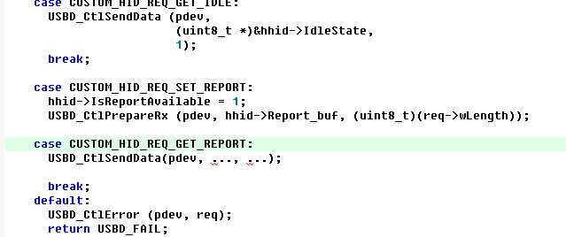

Posted on September 12, 2017 at 12:18
Thanks for replying John.
I am able to create a report descriptor and transmit it but the point is that I don't know how to send feature report over usb (which function to use).

My question is: Which function should I use to respond to GET_REPORT(feature) requests?

Posted on September 13, 2017 at 05:08
Ah, I misunderstood your question.
I think if the 'Feture report' were sent via contol pipe as described in HID1_11 document, following function would be used.
  - USBD_CtlSendData (USBD_HandleTypeDef *pdev, uint8_t *pbuf, uint16_t len)
And it need to be added as class specific request in USBD_CUSTOM_HID_Setup() function like below.
I hope this works for you .
Posted on September 19, 2017 at 00:43
Yes I've finally found out. I should have told you.
What you wrote is exactly what I've done and it worked like a charm.
