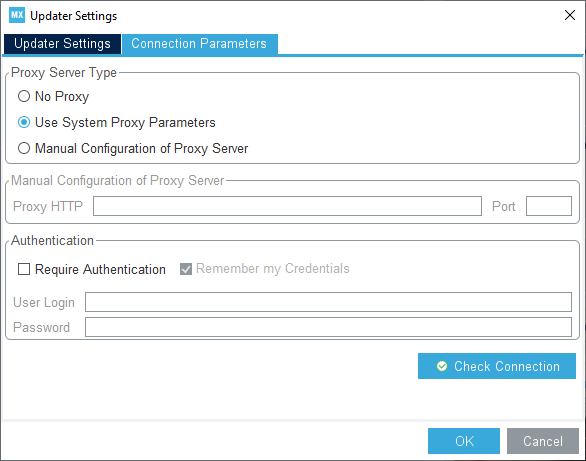

Ahmad M.Nejad
0693W00000Ba51oQAB.pngAbove setting solved my problem
BWaeb.1
I had the same issue. I downloaded the file of RrW and extracted it manually and restarted stm32CubeIDE. Then it worked!
