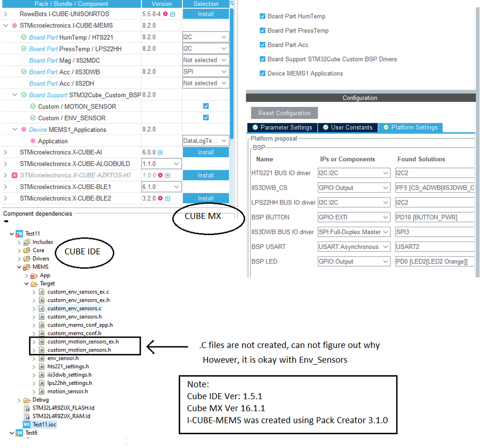

STM32CubeMX does not copy custom_motion_sensors.c and custom_motion_sensors_ex.c files when the code is created.
Shaun.t
STM32CubeMX does not copy custom_motion_sensors.c and custom_motion_sensors_ex.c files when the code is created. Has anyone come across this issue, if yes what was the issue? I have checked in and out but unable to find the issue. I have checked the Free Marker template files and all looks okay. Please see below for more details
Regards
Shaun
