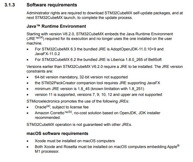

From the documentation:
Starting with version V6.2.0, STM32CubeMX embeds the Java Runtime Environment
(JRE™(a)) required for its execution and no longer uses the one installed on the user
machine.
And yes the installation package contains JRE, but the the files are not executable.
To make the files executable issue the command in the directory where you have extracted the installation package:
sudo chmod 755 jre/bin/*
Now you can run the setup file.
machine.
