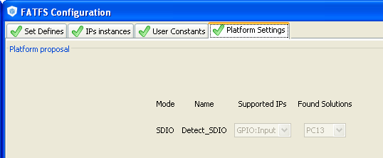

I tried a new version 4.0 of STM32CubeMX. I selected the STM32F746G-DISCO board.
If I set the Detect_SDIO GPIO: Input ad PC13, closed and openedthe ioc file,
then the comboboxes are gray and you can not change.

Posted on March 29, 2016 at 18:19
Thank you for reporting this issue.
As a workaround, from the pinout view, click the corresponding pin and set it to reset. This reopens the platform settings for user configuration. Click the pin to reconfigure it as GPIO_input.

Dear user,
The issue has been solved in STM32CubeMX release 4.15.
