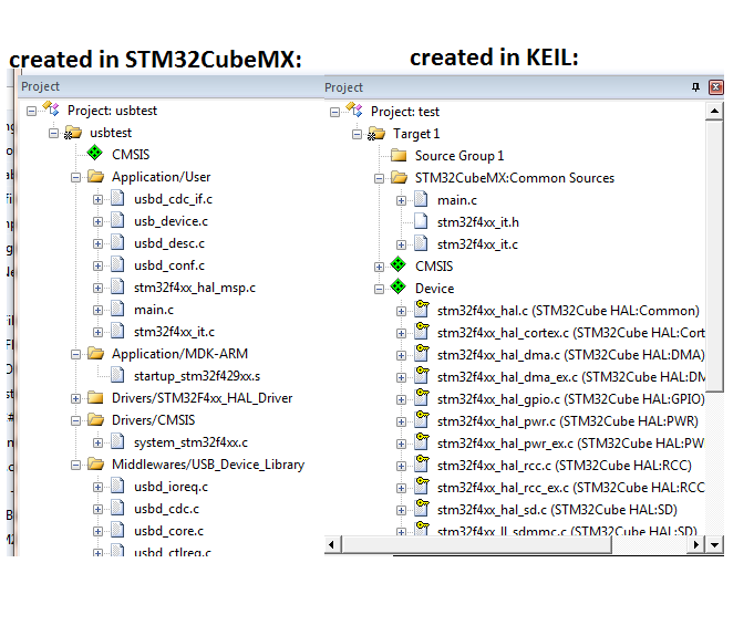

I have problems using STM32CubeMX together with KEIL mdk 5.
When starting a new project in Keil I can use all the Keil functionality, but when I open Cube from the project runtime environment and initialize everything in there, than I am not able to include Middlewares from Cube in my project. It doesn't include all the files as it does when starting a project in Cube. I can add them manually and this works ok, but this isn't a very maintenance friendly way of coding.
On the other hand, when starting a project in Cube I can't add all the Keil CMSIS and Board Support(stm32f4) functionality(only adding RTOS RTX is doable) without getting low level errors.

Sorry, I mean to say that when I create a project in KEIL Uvision and set-up the project as shown here: http://www.keil.com/pack/doc/STM32Cube/General/html/cubemx_proj.html
Than, if I add HAL drivers like I2C and SPI it works fine, but when I add Middleware(such as FATFS) it doesn't include the files in the project.
When creating a project in STM32CubeMX and than open this in KEIL, it works fine, only no possibility to use KEIL CMSIS drivers. I have shown the Keil environment in the screenshot below. USB middleware is added in both, but only the project created in STM32CubeMX has included all the files.
I hope it is clear now, thank you for your response.
