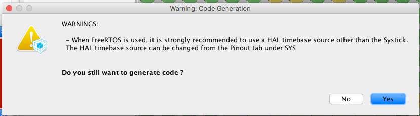

I have a project based on STM32. The project can be configured to run on several STM32 boards.
Each board configuration is represented by the `.ioc` file created by CubeMX.
I want to have a CI (Continuous Integration) setup that will compile the project for all supported boards.
In order to do this I created a Docker image with Java, STM32CubeMX and all the necessary toolchain.
Then I wrote a Cube command line script that generates the code given a `.ioc` file as an input.
I invoke this script as part of a Makefile using a line similar to this:
java -jar STM32CubeMX -q my_script
Since I passed the `-q` flag, I expected that no GUI will be presented.
The docker container crashes executing this line, since it does not have a display capabilities requested by CubeMX, even if it is not going to display anything.
I tried doing this on an actual machine without docker, but then sometimes I would get a popup window during the generation process that requires user intervention.
Such window might pop when you enable FreeRTOS and select SysTick as the HAL timebase source:
This is a problem since the generation process is halted until the user presses a button, which is unacceptable for automated CI environment.
Is there a way to use Cube as a *true* CLI? I would rather it failed when encounter any problem, instead of waiting for user input.
Is such thing possible?

2018-08-22 12:18 AM
I have a very similar problem. As part of my CI process, I want to generate the documentation of a CubeMX project. Therefore, I installed CubeMX on my Jenkins host on command line, which worked like a charm, but when it comes to using CubeMX on command line, I always get the following error:
Exception in thread "main" java.awt.HeadlessException:
No X11 DISPLAY variable was set, but this program performed an operation which requires it.
at java.awt.GraphicsEnvironment.checkHeadless(GraphicsEnvironment.java:204)
at java.awt.Window.<init>(Window.java:536)
at java.awt.Frame.<init>(Frame.java:420)
at javax.swing.JFrame.<init>(JFrame.java:233)
at com.st.microxplorer.maingui.MainFrame.<init>(MainFrame.java:53)
at com.st.microxplorer.maingui.MicroXplorer.run(MicroXplorer.java:165)
at com.st.microxplorer.maingui.STM32CubeMX.run(STM32CubeMX.java:24)
at com.st.microxplorer.maingui.STM32CubeMX.main(STM32CubeMX.java:37)This happens for the easiest possible script with only the exit command in.
Is there any possibility working around this problem?
2018-08-22 2:52 AM
I SOLVED my problem with a workaround: I used xvfb to create a virtual X11 Display before executing CubeMX. This script helps to get it into background: https://gist.github.com/jterrace/2911875
Unfortunately, generate the PDF doc is not part of the scriptable commands... :(
