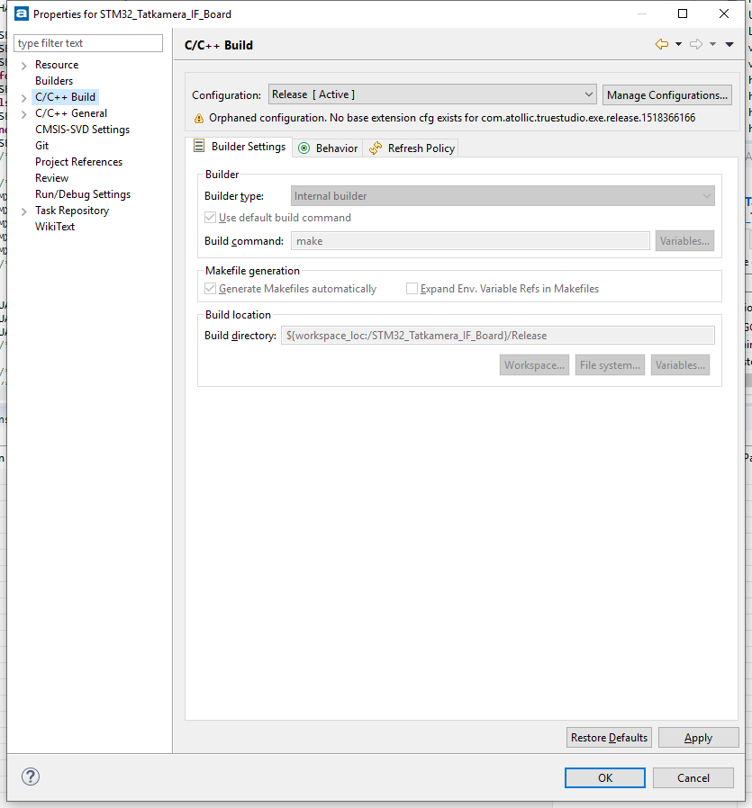

I am using the latest TrueStudio with a project for STM32L452 created using the latest STM32CubeMX.
The created project contains both a debug and a release build. When I set the debug as active and look in one of the files that contains conditional compiles based on the compiler (core_cm4.h) I see that the lines for __GNUC__ are not grayed out. So obviously that compiler is defined somewhere.
However when I set the release build as active and look at that same file, all the conditional statements based on compiler are grayed out, and the final 'else' for 'unknown compiler' is the one not grayed out. So clearly __GNUC__ is not being defined anywhere.
Also, when I go to the build settings and select the release build I see a warning at the top that says 'Orphaned configuration. No base extension cfg exists for com.atollic.truestudio.exe.release.1518366166'. I don't get that when I select the debug build.
So, what does that warning actually mean, and why is the compiler not defined in the release build? (and where is it normally defined?)

Hmm thats worst case end of May... Is there a procedure to manually fix the configuration? I'm very confused by all the different XML Files, can someone explain me which sections I have to copy where to get a working config?

@alister​ I think you got me wrong. The conversion of the project itself kinda works OK. I'm also not expecting many more iterations with the MX tool and regenerating code as the pinout and initialisation is already working okish.
The question was how to fix the error for the release build in the .project and .cproject files I guess.
I can actually change between debug and release build, the _DEBUG_BUILD define gets evaluated by the syntax highlighting e.g.
#ifdef _DEBUG_BUILD
  SEGGER_RTT_printf(0,"Tatkamera IF Board alive (DEBUG Build, GIT Version: %s)\r\n",GIT_HASH);
#else
  SEGGER_RTT_printf(0,"Tatkamera IF Board alive (RELEASE Build, GIT Version: %s)\r\n",GIT_HASH);
#endif
greys out the lower part on DEBUG build and greys out the upper part on a RELEASE build. In the debug and release folders I find in both cases a binary file that has the RELEASE printf text compiled in and they are both binary identical. I could live with both builds using the same optimizer settings for now, but I have conditional code that does for instance CRC checking of the flash in the RELEASE build which is not supposed to be compiled into a DEBUG build because it would not give the correct checksum (which I do after linking with some srecord tool foo, so its not in the downloaded ELF file)
That is my main problem right now.
