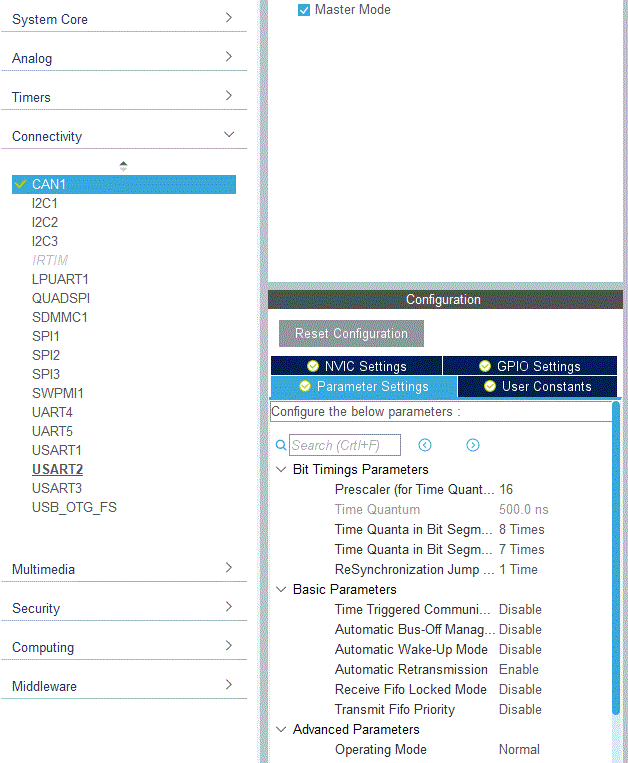

​(1) The CAN1_RX(PB8) and CAN1_TX(PB9) pins of STM32L476RG do not drop the voltage to 0 Volt. Low voltage is 1 Volt.
Tested voltage level with the code below.
hal_gpio_togglepin(GPIOB, GPIO_PIN_8 | GPIO_PIN_9);
(2) Due to the above phenomenon, CAN1_RX(PB8) cannot be lowered to 0Volt to use the built-in CAN bootloader mode of STM32L476RG.
CAN Transceiver does not fall below 2.5 Volt of CAN1_RX(PB8) pin.

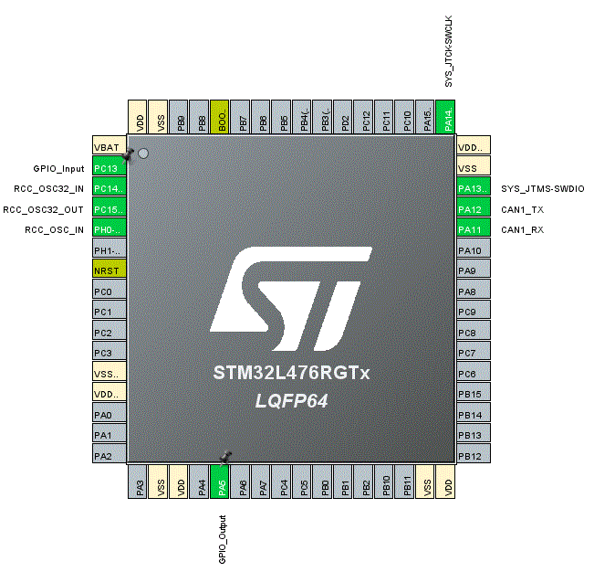

(3) When using CAN1_RX(PA11) and CAN1_TX(PA12), there is no problem from 3.3V to 0V.
However, the CAN Tx output level of the CAN1_TX(PA12) pin remains 3.3V unchanged even when sent from the CAN below function code made with CubeMX.
 if (HAL_CAN_AddTxMessage(&hcan1, &TxHeader, TxData, &TxMailbox) != HAL_OK)
(The oscilloscope measured the point where there is no change in the output pin.)
If the CAN baudrate is not correct, the signal should be output to the CAN1_TX(PA12) pin, but there is no level change. (test 125Kbps)
(4) In loopback mode, the TX data is entered as RX. (called HAL_CAN_RxFifo0MsgPendingCallback)
(but there is no level change of TX pin.)

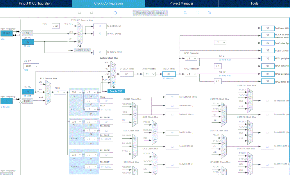

An 8Mhz external crystal has been installed,
but it is irrelevant to the CAN problem, when internal clock occurs the same problem.
